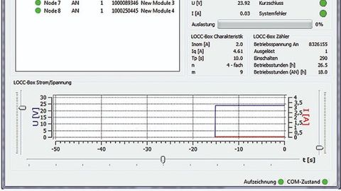

Free 'LOCC-Pads' software: evaluation of relevant system data such as status, parameterization and live data.
© Friedrich Lütze
However, electronic fuses such as the 'Locc-Box Net' or the 'LCOS CCi' family are not just pure protection elements, but can already cover Industry 4.0 requirements today: Both systems continuously record all relevant energy and system data via bus couplers. This includes parameters such as current operating voltage and current, set rated current and characteristics, operating hours of the system and device, overload status or even short circuit and undervoltage. The data can be displayed in the Profinet, Ethercat, Profibus DP, CANopen and Ethernet IP communication systems via bus couplers. The data is evaluated in a control system or a higher-level energy management system, which can then lead to one or all devices connected to the bus coupler being switched off. This makes it easy to switch off consumers that are not required or entire parts of the system. In addition, it is up to the user to decide whether to carry out switching via the standard remote control channel or directly via the communication system. All functions can be graphically visualized and executed via freely usable software or an HMI.
Another important aspect is troubleshooting. Particularly in the case of sporadic overflows, the recording of all relevant data can be displayed in the software via event data logging or sent to the control system including a time stamp.
