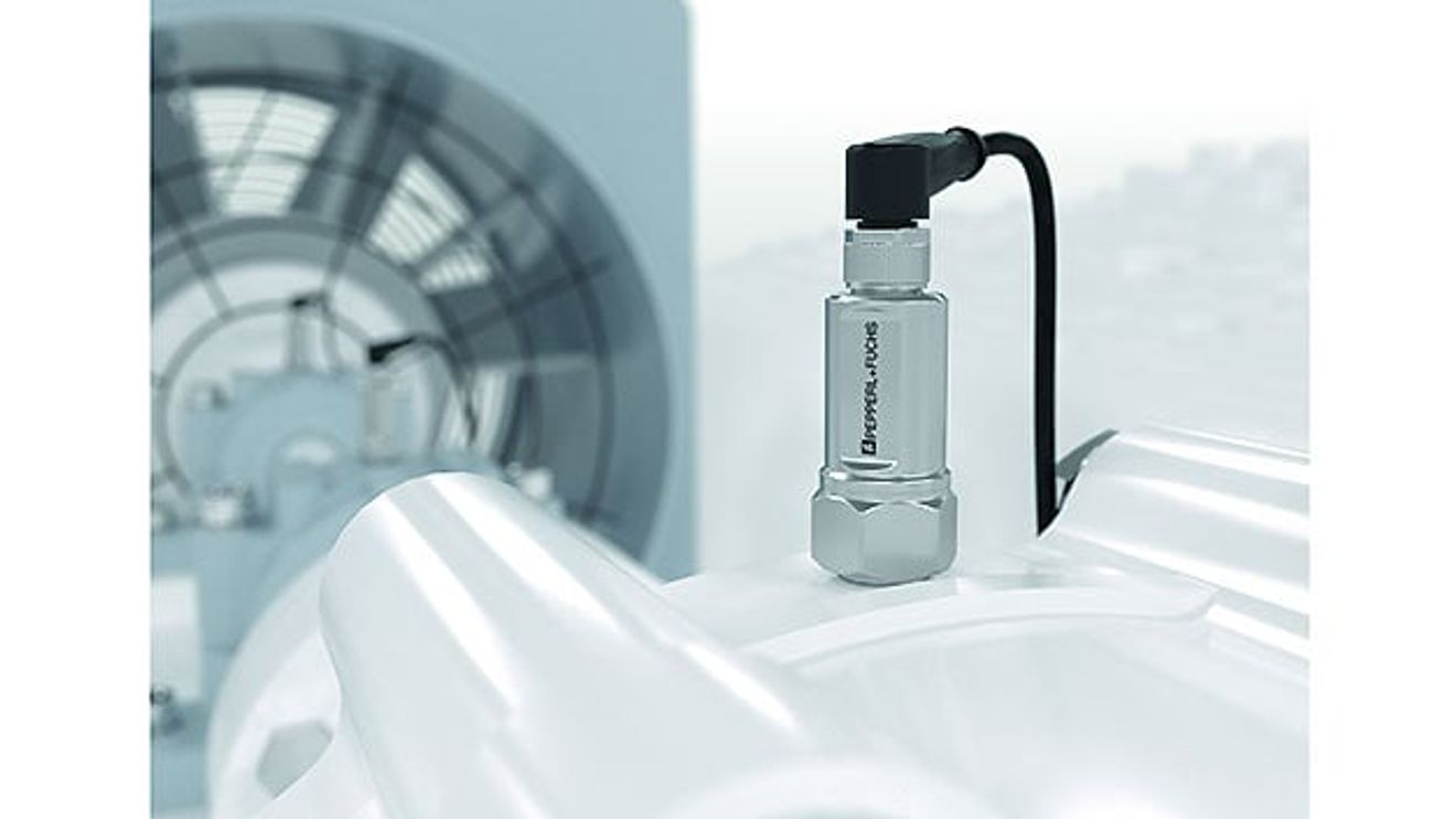

Vibration sensor provides information
Experienced mechanics can hear when an engine or machine is not running smoothly: they recognize a warning signal triggered by a change in vibration behaviour. Vibration sensors do this automatically for real-time condition monitoring.

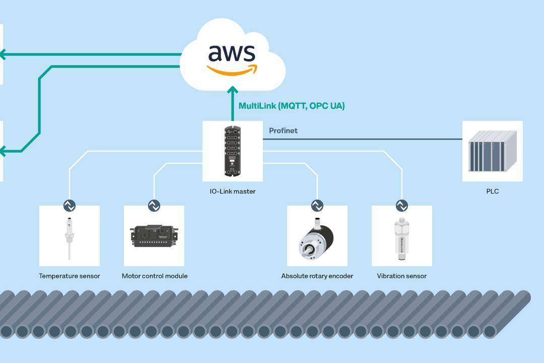

The sensors allow commissioning without programming and parameterization directly on the device. The VIM3 series also offers an optional IO-Link interface and the option of simultaneously collecting several measured values for long-term condition monitoring. In addition to the averaged vibration acceleration (g rms), peak values (g peak), the bearing condition characteristic value for the direct assessment of ball bearings and the temperature can also be output. For the best possible adaptation to the respective application, the sensor offers a wide range of setting options - for example, an adjustable switching signal that can be set up in parallel with IO-Link communication to immediately trigger a defined maintenance task. An additionally implemented counter or an operating time measurement can be used to define how long a machine may exceed a critical vibration value before a subsequent step is triggered. At the same time, the capacity of the control level is conserved as the device carries out the necessary calculation steps itself.
The IO-Link device therefore enables condition-based maintenance of the machine based on precisely defined parameters, which can lead to considerable savings compared to cyclical maintenance. This means that maintenance measures can be planned according to actual requirements. At the same time, there is no need for further adjustments, as the appropriate trigger setting for maintenance can be made directly in the sensor.
