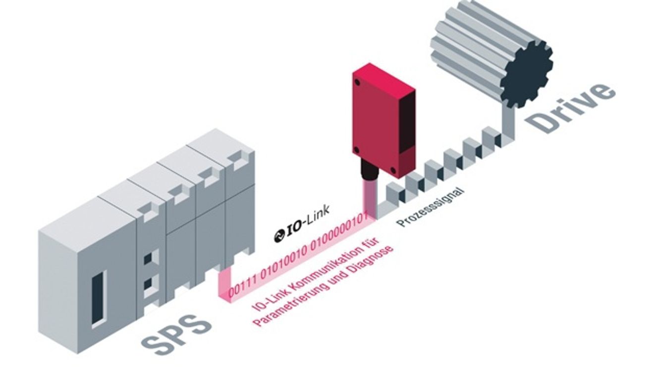

Dual channel with connection to the PLC: The switching output is connected directly to an actuator; the push-button offers options for monitoring and analysis via IO-Link.

1. connection to a PLC
With the 'KRT18B' contrast sensor, for example, which is used in a high-speed packaging machine to determine an exact cut mark position, the packaging quality of the machine depends on the real-time capability of the switching output. For this reason, the switching output of a contrast scanner is better not looped via a controller, but connected directly to an actuator. In order to still provide the option of monitoring and analyzing the machine, the contrast scanner has an IO-Link communication interface in addition to the fast switching output. It can be used to monitor the process value, determine the function reserve and carry out parameterization. It also supports the customer when changing recipes or changing formats.
