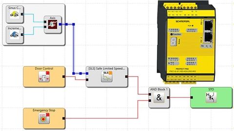

An exemplary structure of the safety function: In addition to the encoder for detecting the speed, the evaluation logic, such as the 'PSC1' safety controller from Schmersal, and the drive itself, the monitoring of the safety gate must usually also be included in the consideration, as the SLS function is generally activated with this.

The PSC1 safety controller and the programming of the application in SafePLC2. Category 3 requires, among other things, fault detection (DC). In the example described, this takes place via the 'PSC1' safety controller. Function blocks for the most important monitoring functions are already integrated in the 'SafePLC2' programming tool of the 'PSC1' and the probability of errors is minimized due to the simple programming.

The single-fault safety required by category 3 is ensured by the continuous two-channel speed/direction detection in the encoder. The fault detection (DC) also required is not integrated in the encoder and must therefore take place in the evaluation logic.
The 'PSC1' safety control series from Schmersal is a good example of this. If required by the application, it can be used to safely monitor up to twelve axes. The encoders can be easily connected via D-Sub interfaces. By cross-comparing the two encoder signals or, in the case of sin-cos encoders, by evaluating the relation sin²+cos²=1, any errors that occur are detected and an error response is initiated. In addition, the 'SafePLC2' programming tool of the 'PSC1' already contains function blocks for the most important monitoring functions in accordance with DIN EN 61800-5-2, for example SLS, SOS (Safe Operating Stop) or SCA (Safe Cam, safe position monitoring). These can be easily integrated into the safety logic program.
