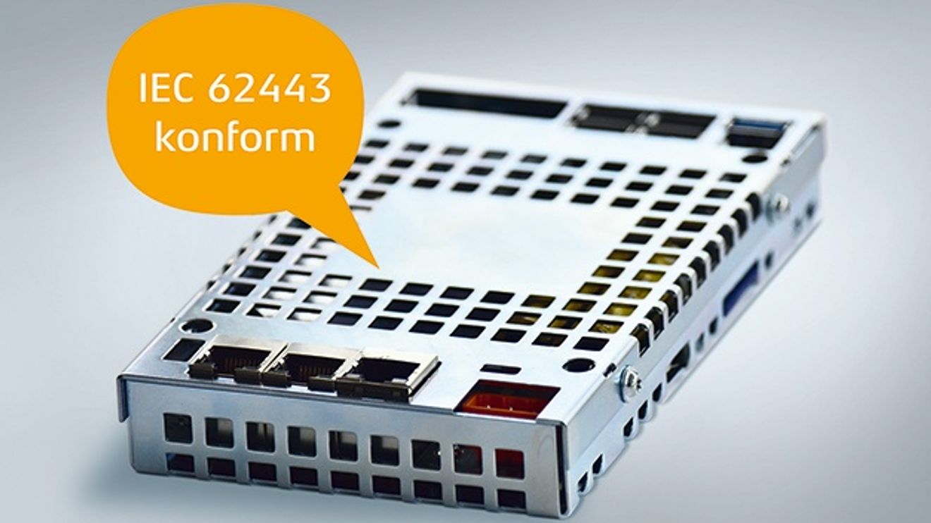

Grossenbacher Systeme has implemented cybersecurity for the Universal Controller in accordance with IEC 62443 - including secure communication mechanisms between the application and system.
