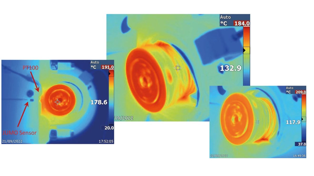

Temperature monitoring of the bearing of a deflection drum (The end face of the shaft was painted to achieve a better degree of reflection. Temperatures of the radial surfaces may therefore be distorted).
