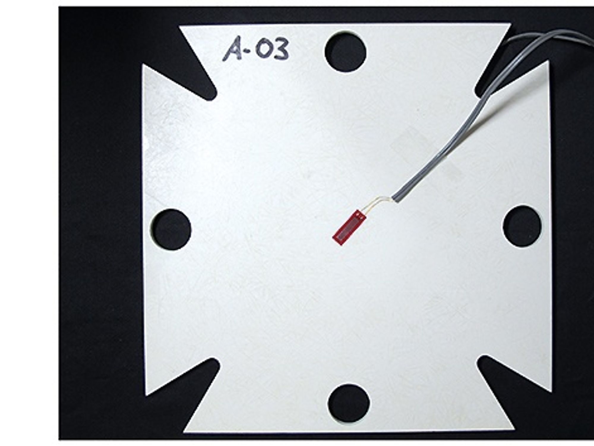

In a material test, the properties and structures of a material are determined in the form of parameters using various physical or chemical tests and measurements. Reliable helpers in this process: strain gauges.
<p>Shear test to DIN EN ISO 14129 with flat specimens in a servo-hydraulic testing machine from MTS, in which a strain gauge rosette with a measuring grid length of 10 mm is used. The shear properties (shear modulus, shear strength and maximum shear strain) are determined. No testing device is required for the test; a standard clamping system is sufficient.</p> © Grasse Zur Engineering Company
