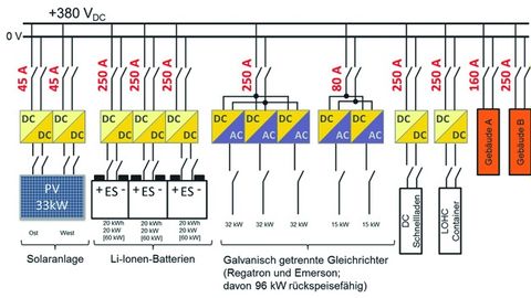

A 380 V DC microgrid was installed at the Fraunhofer IISB (Erlangen): Various DC sources feed into a two-pole 380 V DC bus. Loads include LED lighting and a 24 V (DC) sub-grid for supplying office equipment.

As part of the EU research project DCC+G, a test grid was created at the Fraunhofer Institute IISB in Erlangen, which supplies part of the office building with a DC voltage of 380 V. A new building at the same institute, which is scheduled for completion in fall 2018, will be supplied entirely with DC. Various DC sources feed into a two-pole 380 V DC bus. Loads include LED lighting and a 25 V (DC) sub-network to supply office equipment such as laptops and printers. This eliminates the need for many individual power supply units and there is also no dangerous touch voltage.
