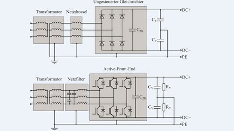

Figure 1: Possible suppliers in the DC grid and earthing concepts: Uncontrolled rectifier on the earthed AC grid (top) and active front-end on the isolated AC grid (bottom).

The DC grid contains one or more supply devices that supply the open DC grid with power from the AC grid. The drive inverters are grouped into logical load zones and connected to the grid using fast semiconductor-based circuit breakers (editor's note: the protection concept is explained in detail in another part of this series of articles). The claim of the DC-Industry system concept is that it can be used to implement small, spatially concentrated DC grids as well as large or spatially extended systems.
For small DC systems, cost-effective, uncontrolled rectifiers(Fig. 1, top) can be used, which are operated as usual on the earthed AC supply. If an entire production hall needs to be supplied, the current flow and DC voltage can be controlled with regulated power supplies - so-called active front-end rectifiers. This additional degree of freedom is used for intelligent grid management.
In principle, however, an AFE converter generates a high-frequency common-mode voltage from the DC connections to the star point of the upstream AC grid. This common-mode shift is avoided by an isolating transformer connected upstream (on the AC side). This is not earthed on the output side. In this case, the system concept provides for a high-impedance and capacitive earthing of the DC grid - i.e. a so-called 'quasi-IT grid'(Figure 1, below). This earthing concept offers further advantages: For example, the DC grid can continue to operate for a limited time if an earth fault occurs. Parallel operation of several feed-in devices is also possible without any problems, provided each device is assigned an independent secondary winding. When supplying a large DC grid for an entire factory building, the existing medium-voltage supply transformer can take over the potential separation; an additional isolating transformer is then not necessary.

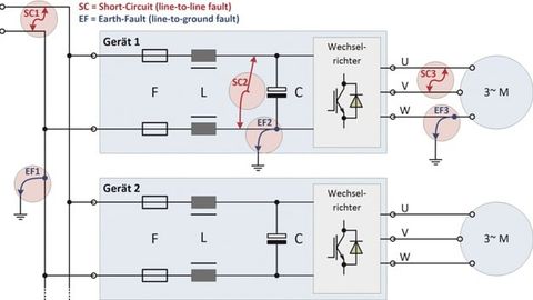

As with AC grids, various faults can also occur in DC grids. These are generally manageable and therefore not critical. However, the protective measures for an open, decentralized DC supply differ in some respects from those for an AC supply. In the event of a short circuit, all the capacitance in the DC network discharges via the fault location and high current peaks occur. These also flow into the fault location from non-defective devices. For an open DC system, it is important that devices do not break as a result.
Figure 4: Representation of two devices in the DC grid with relevant components and possible fault locations: on the input side, inside the device and on the output side.
© Lenze
Figure 4 shows two drive systems consisting of a drive inverter (device 1 and device 2) with one motor each. In the arrangement shown, short circuits (SC: Short Circuit) and earth faults (EF: Earth Fault) can occur at different points. While an earth fault (EF1 or EF2) on the AC side always leads to failure of the DC network, continued operation is possible with DC-side earthing (quasi-IT) regardless of the fault location. Here, neither +UDC nor -UDC have a low-resistance connection to earth potential. It is therefore only necessary to switch off the DC grid in the event of a second earth fault.
Fault SC3 is a short circuit on the motor side of an inverter. The conditions here do not differ in principle from AC-supplied devices; as a rule, the inverter will detect this fault itself and switch it off. Fault EF3 - an earth fault on the motor side of an inverter - is also usually detected by the inverter itself. The only difference between faults SC1 and SC2 is that in the case of SC2, device 1 is defective. The effects of SC1 and SC2 are identical for device 2. In both fault cases, the load zone is disconnected from the upstream DC grid by a protective device (DC feeder).
During normal operation, the DC link capacitors of devices 1 and 2 are charged to their operating voltage. If the SC1 fault occurs, the energy stored in the DC links is discharged directly via the short circuit. Resistive components in the resulting current circuit (line deposits, ESR of the capacitors, etc.) and parasitic inductances (line deposits, stray component of the common mode choke, etc.) dampen the rate of current rise and the pulse-like peak current. However, measurements have shown that a peak current of almost 1 kA can be expected for a device with 1 kW power, although the nominal operating current is less than 2 A. The capacitors in particular are subjected to considerable stress by the pulse current and must be designed in such a way that they can withstand this sufficiently often over their service life.
Another problem is caused by the inductances in the short-circuit circuit. After discharging the capacitors, these continue to drive the current and feed the energy back into the intermediate circuit (resonant circuit). This is then recharged to a negative voltage. The freewheeling diodes of the inverter then become conductive and take over the current depending on their conduction properties. The freewheeling diodes must also be able to withstand this fault sufficiently often.
