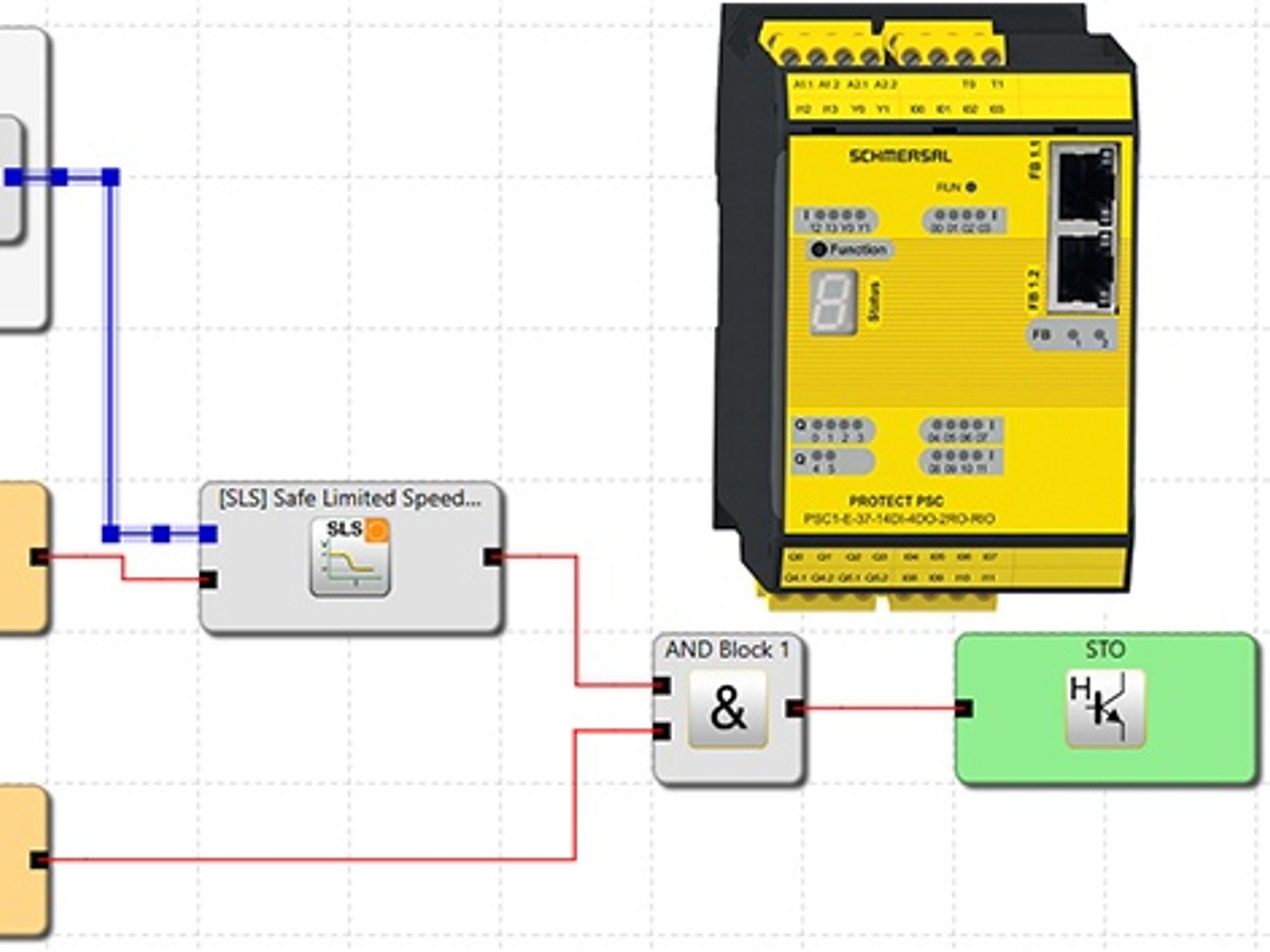

The safety function 'Safely limited speed with safety gate open' is relevant for set-up operation or troubleshooting on machines. Below is an example of a safety solution with a redundant encoder and safety controller.
<p>The PSC1 safety controller and the programming of the application in SafePLC2. Category 3 requires, among other things, fault detection (DC). In the example described, this takes place via the 'PSC1' safety controller. Function blocks for the most important monitoring functions are already integrated in the 'SafePLC2' programming tool of the 'PSC1' and the probability of errors is minimized due to the simple programming.</p> © Schmersal
