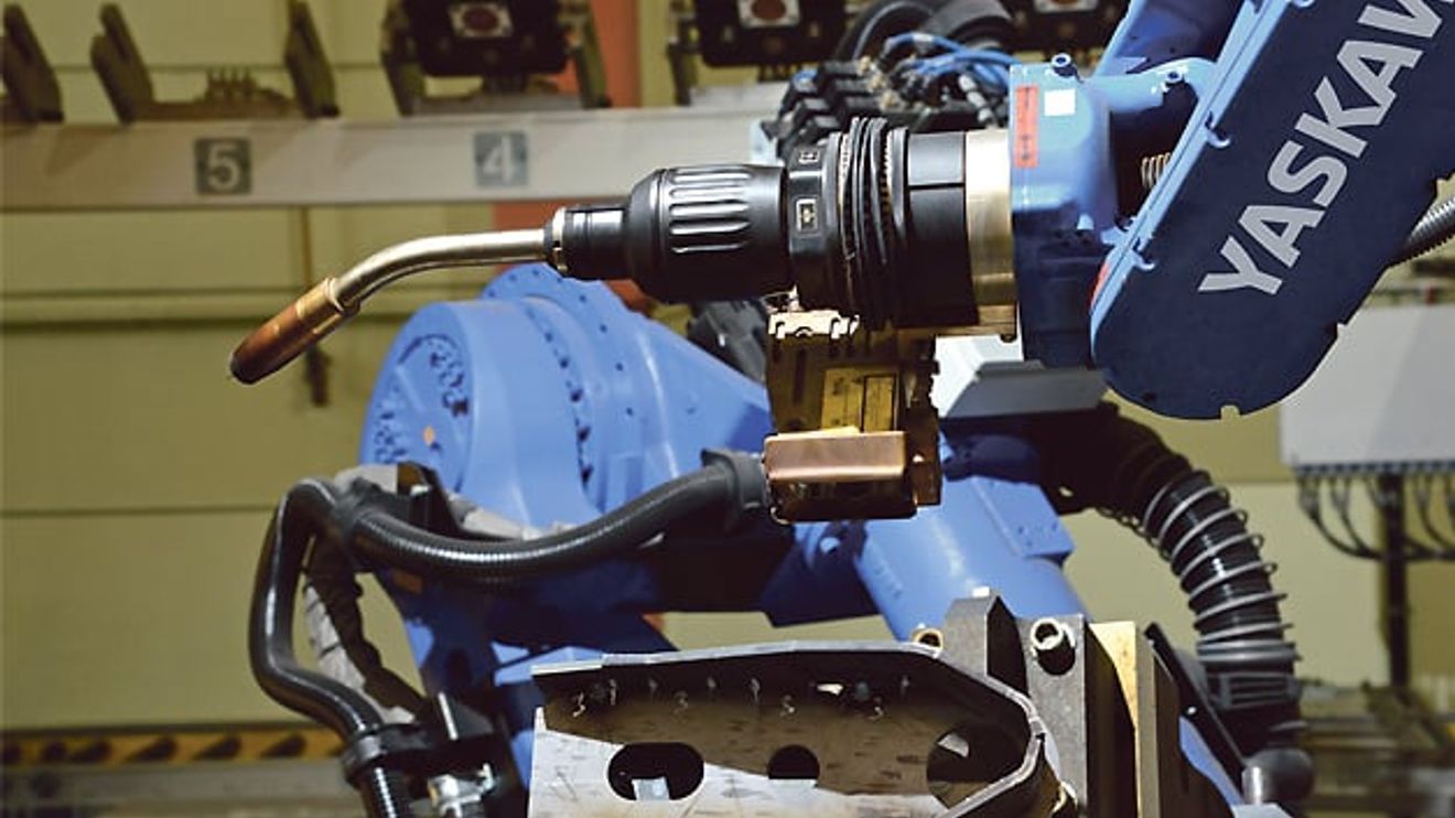

In fixtureless welding, one robot guides the workpiece while the other takes over the joining.

Erwin Schwarzl, production technician at Doka, explains the overriding aim of this investment project: "We wanted to produce the large number of individual parts that had to be welded manually more economically. The requirement was to switch from cost-intensive warehousing to just-in-time production of various components. This task was to be performed by a jigless robot cell, which has to complete different production orders up to batch size 1, even in unmanned shifts."
Jigless robot welding offers significant advantages simply by eliminating tedious clamping and tacking processes as well as the possibility of autonomous welding in unmanned shifts, but places high demands on the robotics: "Jigless is one of the most demanding disciplines in automation technology. Such cells are true guarantors of flexibility - but only if they are optimally designed, the appropriate robots are used and the user has the relevant expertise," emphasizes Sepp Hautzinger from Yaskawa Europe.
Doka met these entry-level requirements to a sufficient degree. The Austrians have been using robots since 1980. Today, well over 100 robots work in production at the Amstetten plant. Even before investing in the new cell, the Doka production team and the welding experts from Yaskawa jointly checked the complete range of welding tasks to be carried out for their jigless suitability, as not every component can be welded freely in space simply by positioning it with a handling robot. To put it simply, small tolerances of the components to be welded and a low expected distortion speak in favor of jigless welding, while, on the other hand, large production-related deviations from target contours and particularly difficult joining constellations can make the process significantly more complex or even impossible.
Once the feasibility was beyond question, the next step was to design the high-tech cell. The result is currently setting standards for automated welding: "The jigless cell at Doka is one of the most modern robotic welding systems in the world," Hautzinger is convinced. It uses the latest DX 200 robot controller from Yaskawa, a state-of-the-art Fronius welding power source including a new, fully automatic torch neck changing system, the MotoSense laser-based seam tracking system, also from Yaskawa, an application-specific modified Kardex shuttle feed system, a fully automated gripper changing system for the handling robot and a higher-level PLC.
