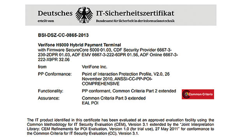

Image 1: The Verifone H5000 payment terminal was tested by the BSI according to Common Criteria (CC). CC certification is actually intended to prevent the case that has now occurred. A gap analysis would be helpful to find out why the causes of the H5000 failure could not be identified during the BSI verification and validation work and whether the depth of testing according to EAL POI is sufficient.

The cyber security of the Verifone H5000 is somewhat different. Due to its application, this module has a very comprehensive Common Criteria security approval from the BSI (Fig. 1). However, manufacturers and operators should not assume that nothing can go wrong. Despite the approval test, there may be faulty program code that was not detected during the code analysis. The expiration date of a security certificate and other possible attack vectors also continue to represent existing operational security risks with a corresponding probability of occurrence. However, it can be assumed that the parties involved focused primarily on use case evaluations due to the BSI certification prior to the first H5000 deployment.

CC certification: in several respects, a security certification is merely a snapshot, i.e. a snapshot at a specific point in time, which is not necessarily transferable to the entire product life cycle. Without appropriate processes (e.g. DevOps) to adapt hardware and software to changing requirements, neither cyber security nor service availability can be guaranteed over the entire life cycle of a product or solution.
