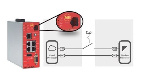

With the 'mbXLink' gateway, the transmission line from the cloud processor to the fieldbus can be disconnected and closed via a built-in key switch.
© MB Connect Line
This galvanic isolation has been implemented accordingly in the 'mbXLink' edge gateway from MB connect line. The basis for this is provided by two units, the fieldbus processor and the cloud processor. The cloud processor takes on the task of communicating in different cloud technologies and protocols. Both processors are installed in one device. They are only connected to each other via two serial transmission lines - as we know it from the classic RS232 connection. The transmission line from the cloud processor to the fieldbus can be disconnected and closed via a built-in key switch. The fieldbus is configured by the cloud processor once during the commissioning phase and the key switch must be set to the 'Config' position. This also closes the transmission line to the fieldbus, which then accepts commands. In Read or Read/Write key switch mode, the fieldbus then continuously sends the fieldbus data to the cloud unit. If access to the fieldbus is necessary, for example to set setpoints, the operator can enable the connection at any time. Once remote access is complete, the connection can be cut again. This means that it is possible to determine on site, depending on the situation, whether data communication towards the fieldbus level is enabled. The decision to establish the connection is therefore always in the control of the operator's system personnel.
