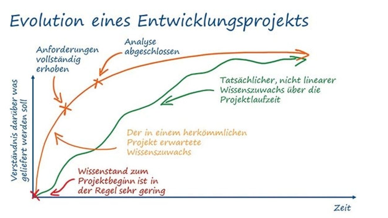

Figure 1: The evolution of a development project.

In theory, requirements management, as described in the standard "IEEE 24765:2017 - Systems and Software Engineering", is a systematic process that is easy to grasp: from requirements elicitation to requirements analysis, requirements specification and requirements validation. In practice, however, it is a great challenge to create good requirements. This is because they should be correct, unambiguous, complete, free of contradictions, rated according to importance and/or stability, verifiable, modifiable and traceable.
>> Read part 1 of the article series "ChatGPT in the industry"!
Two software pioneers put these aspects in a nutshell: As early as 1970, Dr. Winston W. Royce stated that for a development order for a hardware development of around 5 million dollars, a sufficiently good description of the requirements is available with around 30 pages of specifications and a satisfactory project result can therefore be expected. To comprehensively specify a software development project with the same budget, 1500 pages of requirements description would be necessary - for a comparably good project result. In other words, the sheer volume of information to be described is a huge task. Fred Brooks summarized it in his 1995 book "The Mythical Man-Month": "The hardest part of developing a software system is deciding exactly what to build." In addition, in many development projects there is the dynamic that only in the course of the project is enough information available to really decide what really creates value and should therefore be built and what should not. This relationship is also shown in Figure 1 as an orange line (imagination) and a green line (reality).
