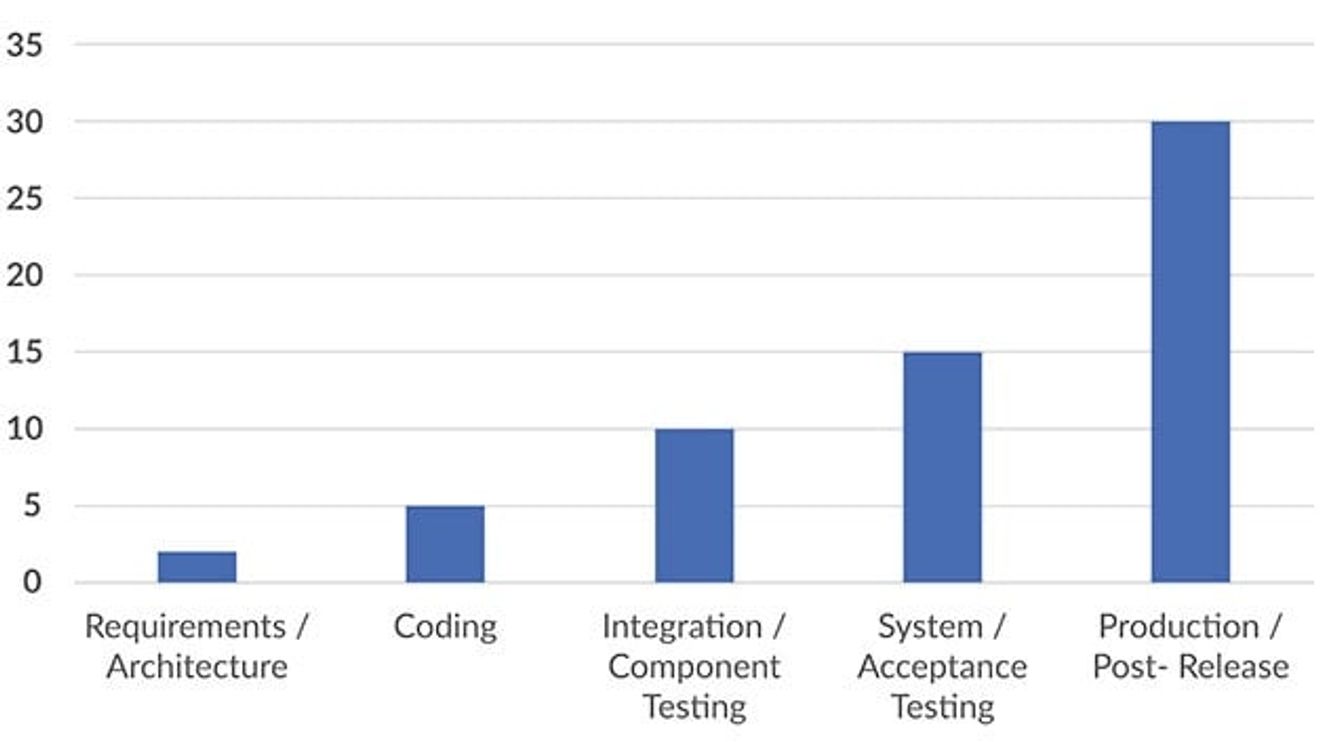

Relative cost of error correction, based on the time of discovery
© National Institute of Science and Technology
Running static analysis on the desktop has several advantages and is suitable for small teams or projects. Large organizations, on the other hand, should also automate static analysis as part of nightly builds and continuous integration. As an integral part of the development process, static analysis of code provides a number of benefits, including the following:
Shorter development cycles: when static analysis is consistently performed in the early stages of a project, it allows systemic bugs to be found and fixed when the cost of fixing them is lowest. This process can initially take more time than the rapid development of software without analysis. However, as the development cycle progresses, the efficiency gains increase exponentially. The elimination of some errors later on is only possible to a limited extent - this makes early detection crucial.

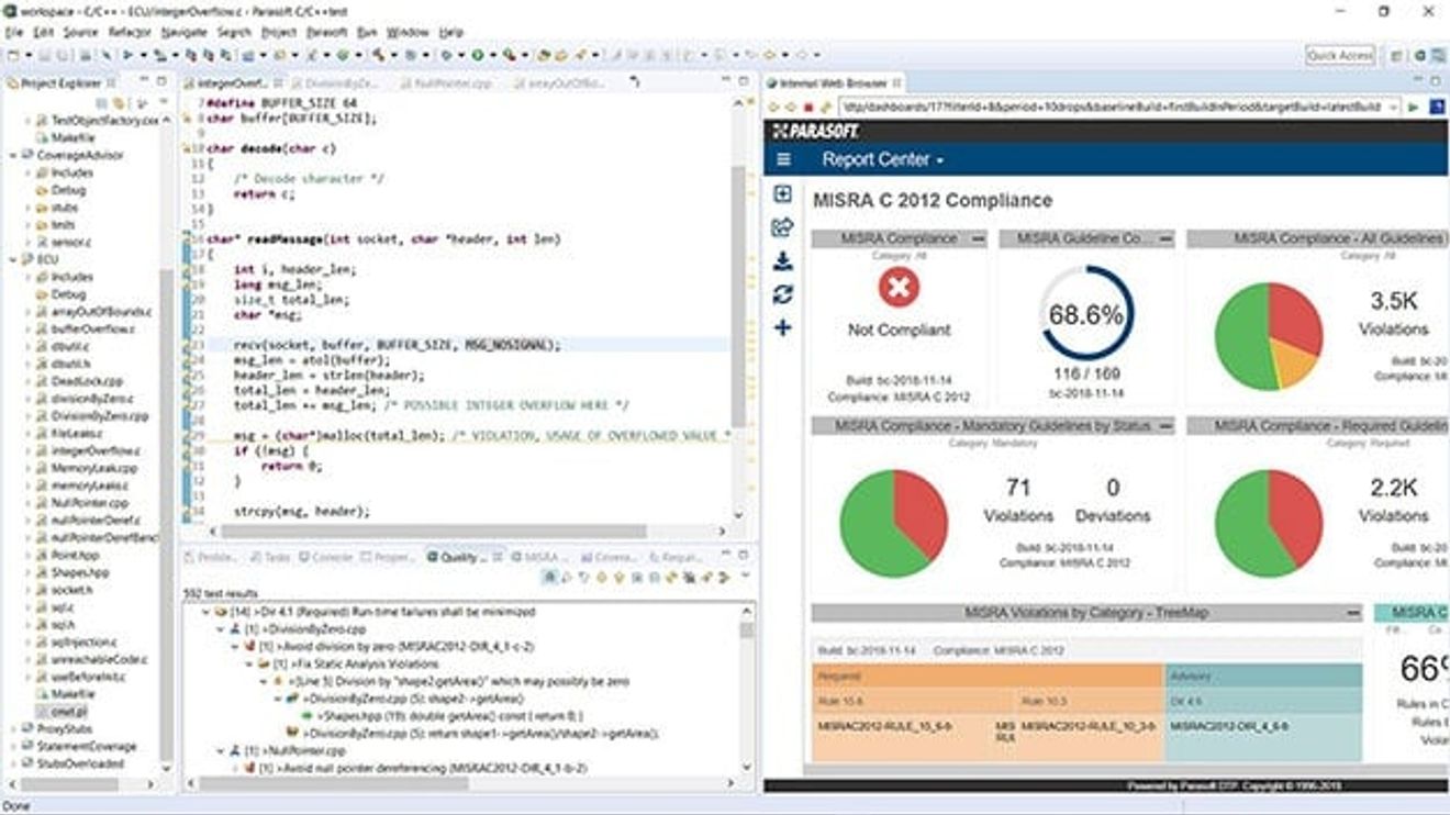

Example of a static code analysis according to the MISRA C++ standard.

Several static analysis tools are available on the market, ranging from open source utilities to full development test suites. Among them, the Parasoft C/C++test software solution provides an integrated platform for automating a wide range of software quality practices for multiple programming languages, as well as providing meaningful and comprehensive reports and, supported by the DTP reporting tool, optional intelligent analysis. For C and C++, it offers a full range of static code analysis features and over 2,200 rules (the highest level of tools on the market, based on implementations of MISRA, MISRA C++, Scott Meyers' Effective C++, Effective STL and other established sources). In addition, this development test solution provides a unified solution for the development process.
In terms of functionality, it generates and implements automated unit tests, enables various types of code coverage, including coverage of lines, statements, blocks, paths, decisions/branches, simple conditions and MC/DC. It includes runtime analysis and a tool qualification kit for compliance with functional safety standards. With Parasoft's static analysis, users can analyze code and integrate it into their automated builds to continuously and automatically prevent errors.
For automated workflows that improve collaboration and efficiency, these static analysis engines integrate with Parasoft DTP, which includes workflows for integrating quality into the SDLC. This allows users to define their development guidelines and then automatically enforce non-functional requirements. For example, static analysis is automatically performed during the build, violations are reported to DTP where they are processed, and the results are sent back to the engineer's IDE to view for remediation.
DTP also performs intelligent analysis that enables these workflows to automatically assess the quality and risk of software development. For example, DTP can look for systemic issues related to the coding process or correlate a serious violation in code produced by a junior engineer with a set of unit tests and coverage information to determine how risky the module is. If the correlation indicates a risk level above a certain threshold, the violation can trigger a special continuous process improvement workflow that includes peer code review and additional analysis in addition to the normal troubleshooting tasks.
