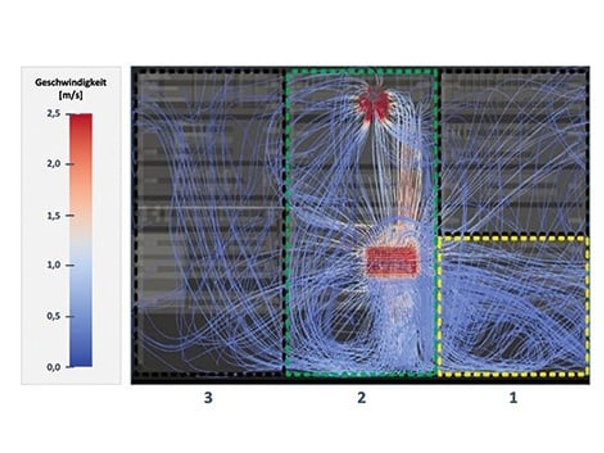

<p>Figure 2: Flow pattern with cooling unit, distribution in the cabinets. The integration of the fans in all cabinets is intended to move the air around the Airstream frames in a targeted manner, as the cold air from the cooling unit does not reach all areas. The optimization offered by the fan in combination with the cooling unit makes it possible to create a homogeneous climate.</p>
