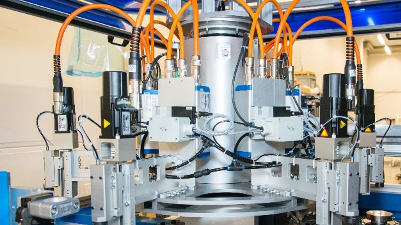

In rotary indexing tables, which are widely used in assembly and test bench technology, for example, different processing stations are placed along an outer radius. Each time they are indexed, they take the component in the workpiece carrier one production step further. If the workpieces on the rotating table also need to be positioned rotationally or linearly, the drives must move with them. Slip ring systems are used to transmit the necessary power and control data. This technology is well established and works reliably over a long service life. However, the topic becomes exciting when safety-relevant data also needs to be transmitted via such a slip ring. Kollmorgen was faced with this task as part of a project for a manufacturer of measuring inspection machines, which used it to examine the behavior of crystalline components.
The combination of Safe Torque Off and single-cable connection technology enables a lean installation with decentralized servo controllers.
© Kollmorgen
The engineering project envisaged installing not only the actuators but also the control system decentrally on the rotary indexing table to save space. Kollmorgen solved this task with the decentralized AKD-N servo controllers and compact AKM synchronous servo motors. The main advantages of the decentralized design and the connection technology between controller and motor with just one cable: small control cabinets and less space required for installation. In addition, the single-cable connection technology with the loop-through option from controller to controller improved the inertia behavior of the rotary indexing table. The requirement for safety technology still had to be met. This is integrated in the test station in the central AKD-C power supply module. Consequently, the connection to the servo axes is required.

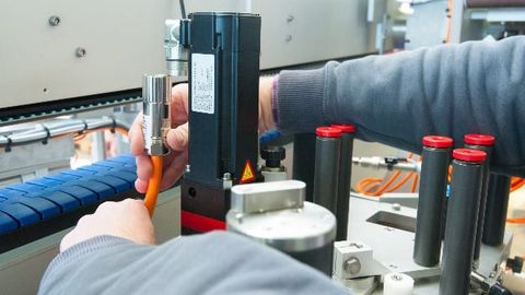

The servomotors can also be installed quickly and space-savingly thanks to the single-cable connection technology.
