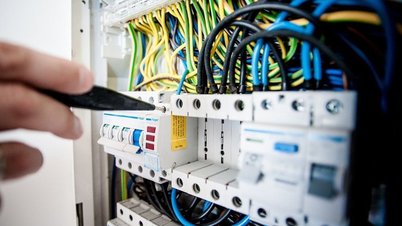

Before starting to check the electrical system, it is essential to check the cable routes. The main concern here is animal lodgers that may have made themselves at home during the break, bitten into cables or built a nest for their offspring. Another recurring problem is wasp nests in de-energized CEE connections or in electrical distribution boards. All of these things must be cleaned up before voltage is applied to the electrical cables again. Failure to do so can lead to serious short circuits and even fires.
Electrical tests
The above checks may be carried out by any member of the factory maintenance team as long as the system is not yet energized. The checks and measurements described below may only be carried out by a qualified electrician. This requires electrical engineering training (journeyman/skilled worker, state-certified technician, master craftsman or graduate engineer) with an additional examination to become a qualified electrician. This is a further training course that must be refreshed at fixed intervals. The VDE 1000-10 standard specifies the corresponding "Requirements for persons working in the field of electrical engineering".
