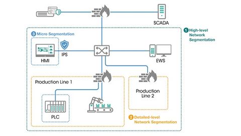

Schematic illustration of the 'Defense-in-Depth' method.

A more advanced design is "defence in depth" with a multi-layer principle: each layer is slightly more secure than the last, with the most important operations and data that must not be compromised under any circumstances in the middle. The "defense in depth" method is the foundation for the Purdue model, which is also recommended in EU cybersecurity guidelines.
